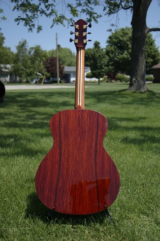

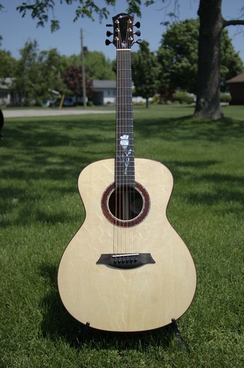

Well here is a guitar #6 that I finished last week. It was my first experience using KTM-9. I used Doolin’s instructions as an outline for the finishing process. It looked something like this.
-filled with epoxy, System 3
-light it dry overnight and lightly sand
-first set of coats the next day
-sand with 600 3M no-load paper
-spray with DA and apply the next set of coats
-level, DA, and the final set of coats.
-let it cure for about 2 weeks
-sand to 1500 and then buff on the pedestal buffer
-buffed using medium and fine compounds

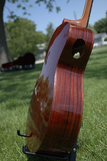

I am very pleased with the results. The KTM was easy to apply and went on crystal clear. When it was all done I went back to look for any blueish tint and could not find any. So I will likely be sticking to this finish for a while.
The back and sides are Cocobolo. Top is bearclaw Englemann. Binding and rosette are Snakewood. Neck is Mahogany, Maple and Coco.

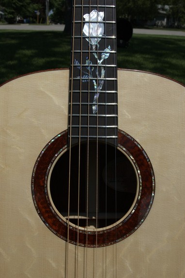

I gained a great deal of respect for our friends who do inlay and are good at it. Not that I didn't respect them before, but I now really know how hard it is to do a good inlay. The rose was my first realy attempt at an inlay. It turned out okay, but I know I have a lot to learn.
This is also the first guitar that I have started and finished since joining the forum. Thanks to everone for your great advice.

Great Job Josh! Nice clarity, and boy do I love that top!

Beautiful Josh. I'm going to have to try KTM-9. There is nothing wrong with that rose, you are are always harder on yourself.

BTW, your inlay skills surpass mine by a large margin.

Josh That is one fine looking instrument. The inlay looks great to me. Finish is beautiful. Snakewood bindings look beautiful too.
